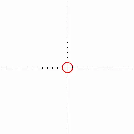

The curve you seek is precisely the involute of a circle, as the animation on the Wikipedia article should make clear:
Image by Wikimedia Commons user "Van helsing", reproduced under CC-BY-2.5.
The perpendicular line at any point on the curve remains at a constant distance to the origin. If you simultaneously rotated the curve in the opposite direction to keep the perpendicular vertical, it would look exactly like your Geogebra sketch.
