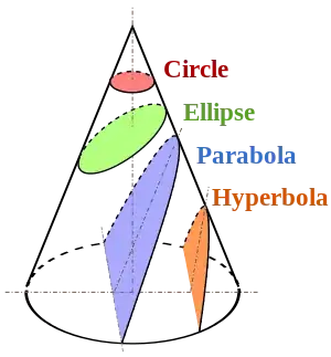

Circles and parabolas are both second degree equations, meaning that they can be created by cutting open a cone (conic sections): (You could also make these by shining a flashlight)
This is related to eccentricity.
You could imagine eccentricity to be how much these graphs are stretched: ($e=$ eccentricity)
circle: $e=0$
ellipse: $0<e<1$
parabola: $e=1$
hyperbola: $e>1$

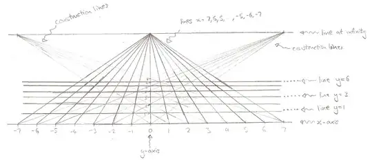

So far, what I've said about the projective plane is just hand-wavy algebra. But projective geometry really stems from trying to draw the world around us: we see the world in perspective, resulting in certain projective features in our vision.
For example, one can imagine that if we lived on a perfectly flat plane that extended infinitely in all directions, then the railroad tracks in this image would appear to meet at the horizon (they don't in the image due to the curvature of the Earth, but a plane has curvature zero, thereby removing that problem). But they're railroad tracks, so they must be parallel - parallel lines that "meet somewhere". The reason they would appear to meet at the horizon is that we would be seeing the projective plane around us, wherein the horizon line would be the line at infinity. This at least makes some intuitive sense: if you're standing on an infinite plane, and you still see a horizon (which you must do if, say, the ground is green and the sky is blue), then the horizon must be infinitely far away: the line at infinity. Moreover, the railroad tracks are parallel lines, so they must meet at a unique point on the line at infinity, i.e., at some point on the horizon.
Now, we can put coordinates on our projective plane: put coordinates on the usual Cartesian (or affine) plane and then imagine that you're standing at $(0,-1),$ looking straight up the $y$-axis. We get something like this:
Hopefully you can fill in the rest of the coordinate system with your imagination. Note that the "vertical" lines $x=7,6,5,\ldots,-5,-6,-7$ are parallel, and hence all meet at the same point on the horizon.

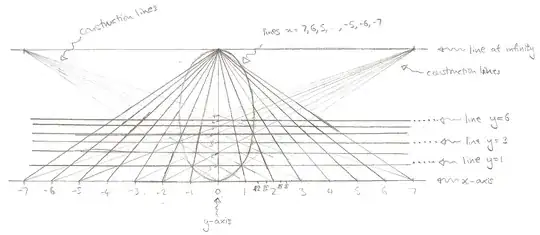

We can sketch the parabola $y=x^{2}$ on such a coordinate system. Here's what we get:
At this point (if my freehand drawing skills are good enough), you might be thinking "Will, that's not a parabola, that's an ellipse" (and if you aren't thinking that, then I need to improve). Indeed, I have more-or-less drawn an ellipse, but you even know in advance that it can't be an ellipse in the usual sense, because it meets the line at infinity.
So you see that, projectively, parabolas and ellipses are at least related, even if you aren't convinced they're the same. With an additional helping of mathematical formalism (which would take a good few hours of lectures to properly explain) one can make everything I've said so far completely rigorous, work in "homogeneous coordinates" and actually write down "projective changes of coordinates", that keep the underlying geometric objects the same (at least, projectively the same) but transform the corresponding polynomial equations into each other, and it turns out that there is indeed a projective change of coordinates that transforms $x^{2}+y^{2}=1$ into $y=x^{2}.$

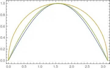

I hope you are not under the impression that these are the only possibilities. There are many different possible curves, infinitely many in fact, parabolas and semi-circles are only 2 examples. The sine curve is neither piecewise parabolical, nor piecewise semicircular. It is a different curve altogether.
The figure below contains a sine function, a parabola and a semicircle, all passing through $(0,0)$, $(\pi/2,1)$ and $(\pi,0)$. You can see that they are indeed distinct.
Half a period of the sine function, a parabola and a semicircle
