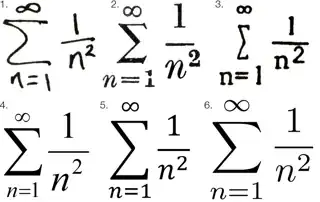

Note
It might be interesting to consider the comparison in the picture below, taken from chalkdustmagazine.com here.
$\hspace{4cm}$ enter image description here
According to the website, the six examples are:
  1. Official Chalkdust font editor’s handwriting, using black Parker fountain pen
  2. Professional typesetting, from a 1954 UCL maths exam paper,
  3. Typewriter, from a 1985 exam paper, in a monospaced font,
  4. Microsoft’s pre-2007 equation editor, using Times New Roman,
  5. Microsoft’s post-2007 equation editor, using Cambria Math,
  6. LaTeX, using Computer Modern.
Notice that in example 1 (handwritten), the $1$ and $n$ are centred, and the superscript $2$ is much smaller than $n$. Hence when writing, it seems to be natural to do this.
For example 2 (manual typesetting), ite seems that the typesetter is trying to centre the $1$ and $n$ as much as possible, although the $2$ is almost the same size as $n$.
For examples 4,5,6 (all computer typesetting systems), the $n$ is off-centre. However, for example 4, the spacing and font size of superscript $2$ seems to be much more pleasing in that it is placed higher than $n$ and is also smaller in size.
    Your superscript 2 in $\pi^2$ is bigger than the superscript 2 in $n^2$, which looks odd to me. – N. Virgo Dec 23 '16 at 07:21
    Yes you noticed that. Somehow I find that the standard font size for $2$ in $\frac 1{n^2}$ is too large and almost the same size as $n$. However, when the same is applied to $\frac {\pi^2}{\cdot}$ it looks ok. – Hypergeometricx Dec 23 '16 at 07:31
    For each fraction individually I agree with you, but I think being inconsistent looks worse than using the standard $n^2$. You could use small superscripts for all of them I suppose. – N. Virgo Dec 23 '16 at 07:47
  • @Nathaniel - Good. Let's see how that looks. – Hypergeometricx Dec 23 '16 at 07:57
    It's so hard not to keep nit-picking... now it looks strange because (i) there is a vertical gap between the top of the $pi$ and the baseline of the $2$, which isn't there in the $n^2$ expression, and (ii) because the superscript in $(-1)^{n+1}$ is still in the original size, as are the expressions above and below the summation sign. For point (i) I'm not really sure why that's happening, since the height of the $\pi$ character looks essentially the same as that of the $n$. I think now I'd hedge towards using the original superscript size throughout, while keeping the centred fractions. – N. Virgo Dec 23 '16 at 08:04
