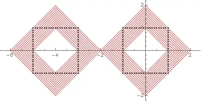

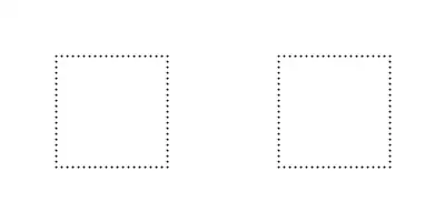

Next I decided to investigate a rotating object with the Taxicab metric to try to understand the idea of rotational invariance. I took a number of points defining the perimeter of a unit square and rotated it. This is what I got:
At first I thought this was very strange until I draw in concentric circles going through every point I used to represent my square.
This demonstrated that each point is simply following a 'circular' path which is what we expect for a rotation. So perhaps my brain is just so used to looking at Euclidean rotation it can't accept that. (As an anology watching a tesseract rotate looks like it is distorting and bending but it just my inability to view it as a 4D object). So is this square rotating correctly? Or is this an example of rotational invarience?

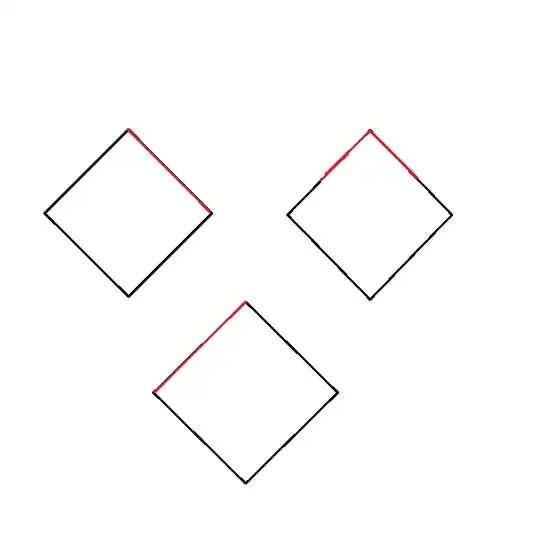

Below we have the unit circle for the $p=1$ p-norm metric. We see that at various stages of rotation we still have the same unit circle since it's invariant under rotation. However, if we rotate one part of the circle, it doesn't remain invariant.

  • Why does the bottom pictures mean it is invariant? It appears we are applying our subjective view of what variation means. The red part looks different in Euclidean space but every point on the red arc has exactly the same radius (just changed angle) so a person used to Taxicab space would see it as not changing. – Ian Miller Dec 14 '16 at 00:27
  • The bottom picture shows that the entire circle is invariant to rotation. However, it also shows that arcs along the circle are not invariant. You can do the same thing with a Euclidean circle. Applying a rotation leaves the object unchanged, so it's invariant. However, arcs along the circle are rotated to other parts along the circle. – Zach466920 Dec 14 '16 at 00:31
  • Ok, thanks, I misunderstood. The picture is showing that an arc varies but a circle doesn't. Can you expand upon this statement you had in your previous answer "In other words, it is rotation invariant. Try it, you can rotate the coordinate system without changing the length. You can't do that with the Taxicab metric, the length you get will change." How can a rotation with the Taxicab metric cause the length to change? – Ian Miller Dec 14 '16 at 00:39
    I think I've partially worked out something. In your three pictures the length between the end points changes. In the first and last picture the length between end points is 2 while the middle one has a a distance between end points of only 1.This doesn't happen in Euclidean rotation. – Ian Miller Dec 14 '16 at 02:33
  • @Ian Miller: the point you make in your last comment here explains why the symmetry group of the taxicab unit circle contains only four rotations, not all of them. Most taxicab "rotations" (maps that move points along taxicab circles) are not isometries, even though they all map the unit circle onto itself. This takes some retraining of your intuition. – symplectomorphic Dec 14 '16 at 16:28
