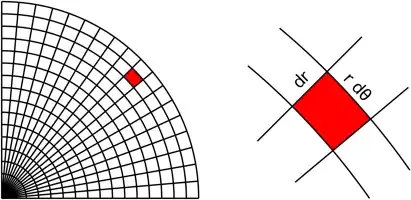

The reason we get an extra "r" can be intuitively seen as follows:
in cartesian coordinates, $dx \ dy$ is our "unit of integration" (a small square). Similar to this, in polar coordinates, our "unit of integration" is a "very thin band" which is of the form $dr \ dl$ where $dr$ is the direction "outward" from the origin, and $dl$ is the small band. However, we know that $dl = r \ d\theta$
(from the usual arc-angle formula $l = r \theta$). Hence, our unit of integration will be
$$ dl \ dr = (r \ d \theta) \times dr = r \ dr \ d\theta $$
