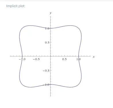

Find the area inside the plot $x^4+y^4=x^2+y^2$.
Plot

Using polar coordinates, we have $x = r\cos \theta, y = r\sin \theta\implies x^4+y^4 = r^4(\cos ^4 \theta + \sin^4 \theta)= r^4(1 - 2\sin^2\theta\cos^2\theta)= x^2+y^2 = r^2\implies r^2 = \dfrac{1}{1-2\sin^2\theta\cos^2\theta}\implies r = \dfrac{1}{\sqrt{1-2\sin^2\theta\cos^2\theta}}\implies \text{Area} = 4\displaystyle \int_{0}^{\frac{\pi}{2}}\int_{0}^{\frac{1}{\sqrt{1-2\sin^2\theta\cos^2\theta}}}rdrd\theta$. Can you continue?

Polar form is $$ r^4\left(\cos^4(\theta)+\sin^4(\theta)\right)=r^2\tag{1} $$ which gives $$ r^2=\frac1{\cos^4(\theta)+\sin^4(\theta)}\tag{2} $$ The area is $$ \begin{align} \frac12\int_0^{2\pi}r^2\,\mathrm{d}\theta &=\frac12\int_0^{2\pi}\frac{\mathrm{d}\theta}{\cos^4(\theta)+\sin^4(\theta)}\tag{3}\\ &=\frac12\int_\gamma\frac{8}{z^4+6+z^{-4}}\frac{\mathrm{d}z}{iz}\tag{4}\\ &=\frac4i\int_\gamma\frac{z^3\,\mathrm{d}z}{z^8+6z^4+1}\tag{5}\\ &=\frac1i\int_\gamma\frac{\mathrm{d}z^4}{z^8+6z^4+1}\tag{6}\\ &=\frac4i\int_\gamma\frac{\mathrm{d}z}{z^2+6z+1}\tag{7}\\ &=8\pi\operatorname*{Res}_{z=-3+2\sqrt2}\left(\frac1{z^2+6z+1}\right)\tag{8}\\[6pt] &=\sqrt2\,\pi\tag{9} \end{align} $$ Explanation:

Let's look at the area below the part of the curve from $(0, 1)$ to $1, 1)$ and the line $y = x$. The total area is 8 times this.
The area below $y = x$ is obviously $1/2$.
If $x^4+y^4=x^2+y^2 $, $y^4-y^2 =x^2-x^4 $ or, trying to be clever, $y^4-y^2+1/4 =x^2-x^4-1/4+1/2 $ or $(y^2-1/2)^2 =1/2-(x^2-1/2)^2 $ or $y^2 =\frac12+\sqrt{\frac12-(x^2-\frac12)^2} $ so that $y =\sqrt{\frac12+\sqrt{\frac12-(x^2-\frac12)^2}} $.
At the moment, I don't know how to integrate this.
But, Wolfy numerically says that $\int_0^1 y dx \approx 1.05536 $, so the area between this ans $y=x$ is about $0.55536 $ so that the total area is about $8*0.55536 =4.44288 $
marty cohen
  • 107,799
After proceeding with the polar coordinate, it suffices to evaluate the following: $$I = 4\int_{0}^{\frac{\pi}{2}}\dfrac{d\theta}{2-\sin^2(2\theta)}= 2\int_0^{\pi}\dfrac{dx}{2-\sin^2x}$$.
Now do a tangent substitution: $$\tan x = t\Rightarrow \sin^2x = \dfrac{t^2}{1+t^2},\,\, dx = \dfrac{dt}{1+t^2}$$
Finally, $$I = 4\int_0^{\infty}\dfrac{dt}{2+t^2} =2\sqrt{2}\cdot(\arctan(\infty) - \arctan(0)) = \sqrt{2}\pi = 4.4429...$$
