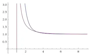

Also notice that the functions of these sums are similar to the zeta function; $\color{blue}{S_m} \sim \color{red}{\zeta}$
But I think it's only due the fact that they all approach $1$?
