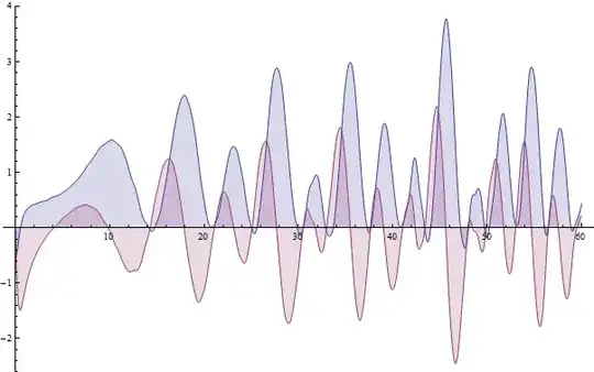

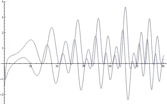

Plot 1: Real and imaginary parts of the discrete Fourier like transform of exponential sawtooth waves, times some number $a$ as a scale factor. Fourier like transform of exponential sawtooth waves times scale factor

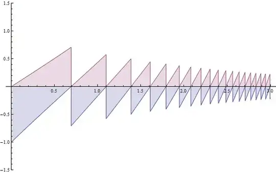

Plot2: Real and imaginary parts of the Riemann zeta function on the critical line. The Riemann zeta function on the critical line

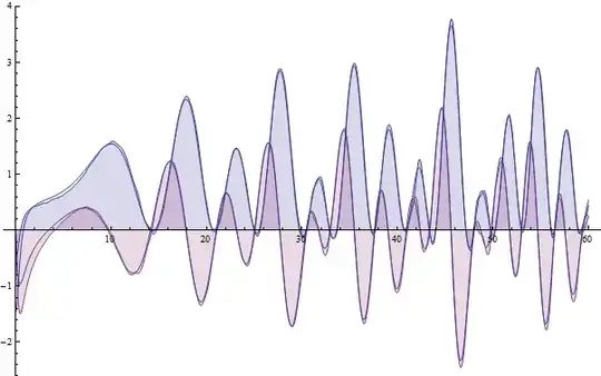

Plot3: The two plots above superimposed. The two plots above superimposed
The Mathematica program for the plots is:
NN = 1000000;
xres = .002;
x = Exp[Range[0, Log[NN], xres]];
tmax = 60;
tres = .060;
Monitor[errList1 =
   Table[Total[((x^(-1/2 + I t)*(SawtoothWave[x] - 1)))]*(1/2 +
       I t), {t, Range[0, tmax, tres]}];, t]
Monitor[errList2 =
   Table[Total[((x^(-1/2 + I t)*(SawtoothWave[x] + 0)))]*(1/2 +
g1 = ListLinePlot[
   14.134725141734693790*{Re[errList1]/Length[x], -Im[errList2]/Length[x]},
   DataRange -> {0, tmax}, Axes -> True, PlotRange -> {-2.6, 4},
   ImageSize -> Full, Filling -> Axis];
g2 = Plot[Re[Zeta[1/2 + I t]], {t, 0, tmax}, PlotRange -> {-2.6, 4},
ImageSize -> Full];
g3 = Plot[Im[Zeta[1/2 + I t]], {t, 0, tmax}, PlotRange -> {-2.6, 4},
   ImageSize -> Full];
Print["Real and imaginary parts of the discrete Fourier transform \
like plot of exponential sawtooth waves, times some number as a scale \
factor"]
Show[g1]
Print["Real and imaginary parts of the Riemann zeta function on the \
critical line"]
Show[g2, g3]
Print["The two plots above superimposed"]
Show[g1, g2, g3]
In the program the scale factor happens to be close to the first Riemann zeta zero, but this is not true since changing the parameter "NN" requires a different scale factor. I apologize if the plots are a bit oversized.
