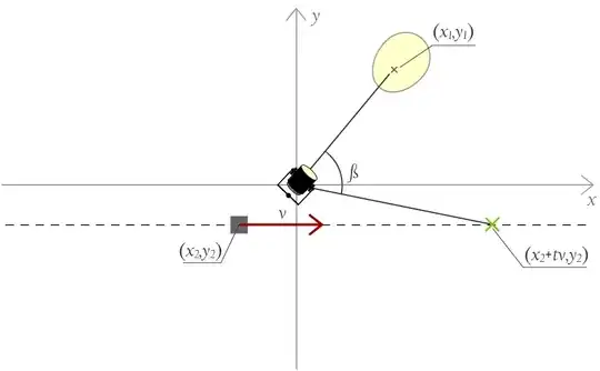

Setting. Suppose we have a scene and a spotlight above it that can be turned onto any object on the scene. On the scene we have an object that moves uniformly and linearly. We are given the angular velocity of the spotlight, the speed of the object and initial positions of both. The question is what is the minimal amount of time before we can put the object in the center of the light spot, and at what angle the spotlight should be moved?
Mathmatical formulation.
Given. Let consider 3d space with Cartesian coordinate system so that the object moves on the plane $xOy$ parallel to the $x$-axis, spotlight is hang at the point $(0,0,h)$ and shines onto $(x_1,y_1,0)$, i.e. onto $(x_1,y_1)$ on the plane $xOy$. The spotlight angular velocity is $\varphi$. The object initially starts at the point $(x_2,y_2)$ and moves at the speed $v$, so the velocity vector is $(v, 0)$ (or globally $(v, 0, 0)$).
To find. The minimal amount of time $t$ before we can put the object in the center of the light spot is the unknown. By that time the object will reach the position $(x_2+t\cdot v, y_2)$, so the spotlight would have to move directly from $(x_1,y_1)$ onto $(x_2+t\cdot v, y_2)$ by turning through an angle $\beta$, which is the angle between vectors $(x_1,y_1,-h)$ and $(x_2+t\cdot v, y_2, -h)$.
Equation. The above gives us the following equation: $$ \frac{\beta}{\varphi} = t, $$ where $\beta$, as was defined before, is the angle between vectors $(x_1,y_1,-h)$ and $(x_2+t\cdot v, y_2,-h)$. Using the formula for cosine between two vectors — $\cos{\beta}=\frac{\overline{a}\cdot \overline{b}}{|\overline{a}|\cdot|\overline{b}|}$ — we get:
$$ \frac{1}{\varphi}\cos^{-1}\frac{x_1(x_2+t\cdot v)+y_1\cdot y_2 + h^2}{\sqrt{\left(x_1^2+y_1^2+h^2\right)\left((x_2+tv)^2+y_2^2+h^2\right)}} = t, $$
