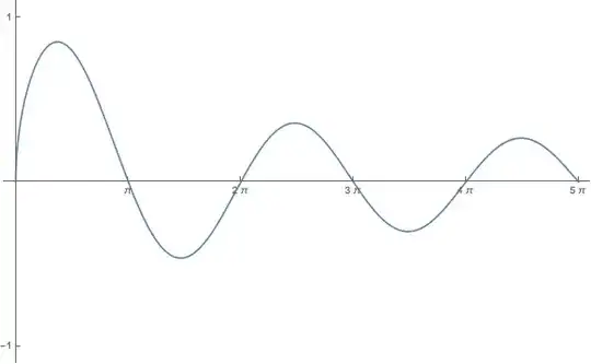

A simple function with this property is $f(x)=\sin(x)/\sqrt{x}$, whose graph looks like so:
A simple appeal to the alternating series test shows that the integral converges, as $$\int_0^{\infty} f(x) dx = \sum_{k=0}^{\infty}\int_{k\pi}^{(k+1)\pi} f(x) dx.$$

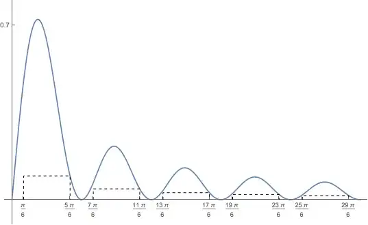

To see that the integral of $f(x)^2$ diverges, let's take a look at a graph of $f(x)^2$:
Each dashed rectangle that you see lives over an interval of the form $[k\,\pi+\pi/6,k\,\pi+5\pi/6]$, which has length $4\pi/6$ or $2\pi/3$. The height of each rectangle is $$\frac{\sin^2(k\,\pi+5\pi/6)}{k\,\pi+5\pi/6} = \frac{1/4}{k\,\pi+5\pi/6}.$$
Thus, the sum total of the areas of those rectangles is $$\sum_{k=0}^{\infty} \frac{\pi/6}{k\,\pi+5\pi/6} = \infty.$$
As those rectangles lie wholly under the graph of the squared function, the improper integral must diverge as well.
