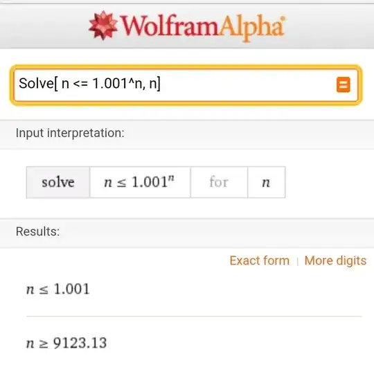

As a small example, we set $\epsilon = 0.001$ and ask mathematica to find our answer:
meaning your lower bound is $9123.13$ or that your delta is $\delta = \frac{1}{9123.13} $
