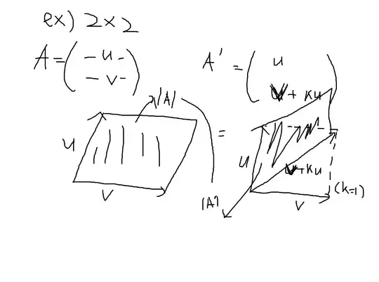

A multiple of any row can be added to another, this kind of row elementary operation does not change the determinant value. The picture below illustrates an intuitive understanding of that, too.
Math
Writing the sides of the parallelogram as rows or columns of a square matrix, this transformation transforms it to another with the same value of the determinant.

    I guess your queries are answered here: http://math.stackexchange.com/questions/668/whats-an-intuitive-way-to-think-about-the-determinant, http://math.stackexchange.com/questions/250534/geometric-meaning-of-the-determinant-of-a-matrix?rq=1. – StubbornAtom Nov 14 '16 at 17:56
    That image is illegible. Also, could you quote the exact definition? – StubbornAtom Nov 14 '16 at 17:58
  • The image shows the 2x2 determinant as the area of the parallelogram formed by the two vectors. – Momo Nov 14 '16 at 18:00
  • yeah the image shows the the operation (Add a row to another one multiplied by a number) conserve the "determinant" value – jotkey Nov 14 '16 at 18:01

  • I've never seen such a scrappy picture on this site! I don't know whether to feel insulted, or to admire your chutzpah. (Actually I do know...) – TonyK Nov 14 '16 at 21:39
  • I cannot find out from your question what you refer to as the "even-odd definition". – celtschk Nov 14 '16 at 22:03
  • I upvoted this question because of the funny pictures. How did those things survive in a community which will correct you every single comma and downvote your post accordingly to show you how inferior you are? – D1X Nov 14 '16 at 22:14
