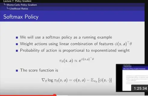

Could someone explain how that derivative was arrived at.
According to me, the derivative of $\log(\text{softmax})$ is
$$ \nabla\log(\text{softmax}) = \begin{cases} 1-\text{softmax}, & \text{if $i=j$} \\ -\text{softmax}, & \text{if $i \neq j$} \end{cases} $$ Where did that expectation come from? $\phi(s,a)$ is a vector, $\theta$ is also a vector. $\pi(s,a)$ denotes the probability of taking action a in state s.

The derivation of the softmax score function (aka eligibility vector) is as follows:
First, note that: $$\pi_\theta(s,a) = softmax = \frac{e^{\phi(s,a)^\intercal\theta}}{\sum_{k=1}^Ne^{\phi(s,a_k)^\intercal\theta}}$$
The important bit here is that the slide only identifies the proportionality, not the full softmax function which requires the normalization factor.
Continuing the derivation:
Using the $\log$ identity $\log(x/y) = \log(x) - \log(y)$ we can write $$\log(\pi_\theta(s,a)) = \log(e^{\phi(s,a)^\intercal\theta}) - \log(\sum_{k=1}^Ne^{\phi(s,a_k)^\intercal\theta}) $$
Now take the gradient:
$$\nabla_\theta\log(\pi_\theta(s,a)) = \nabla_\theta\log(e^{\phi(s,a)^\intercal\theta}) - \nabla_\theta\log(\sum_{k=1}^Ne^{\phi(s,a_k)^\intercal\theta})$$
The left term simplifies as follows:
$$left= \nabla_\theta\log(e^{\phi(s,a)^\intercal\theta}) = \nabla_\theta\phi(s,a)^\intercal\theta = \phi(s,a)$$
The right term simplifies as follows:
Using the chain rule: $$\nabla_x\log(f(x)) = \frac{\nabla_xf(x)}{f(x)}$$
We can write:
$$right = \nabla_\theta\log(\sum_{k=1}^Ne^{\phi(s,a_k)^\intercal\theta}) = \frac{\nabla_\theta\sum_{k=1}^Ne^{\phi(s,a_k)^\intercal\theta}}{\sum_{k=1}^Ne^{\phi(s,a_k)^\intercal\theta}}$$
Taking the gradient of the numerator we get:
$$right = \frac{\sum_{k=1}^N{\phi(s,a_k)}e^{\phi(s,a_k)^\intercal\theta}}{\sum_{k=1}^Ne^{\phi(s,a_k)^\intercal\theta}}$$
Substituting the definition of $\pi_\theta(s,a)$ we can simplify to:
$$right = \sum_{k=1}^N{\phi(s,a_k)}\pi_\theta(s,a_k)$$
Given the definition of Expected Value:
$$\mathrm{E}[X] = X \cdot P = x_1p_1+x_2p_2+ ... +x_np_n$$
Which in English is just the sum of each feature times its probability.
$$X = features = {\phi(s,a)}$$
$$P = probabilities =\pi_\theta(s,a)$$
So now we can write the expected value of the features:
$$right = \mathrm{E}_{\pi_\theta}[\phi(s,\cdot)]$$
where $\cdot$ means all possible actions.
Putting it all together: $$\nabla_\theta\log(\pi_\theta(s,a)) = left - right = \phi(s,a) - \mathrm{E}_{\pi_\theta}[\phi(s,\cdot)]$$
