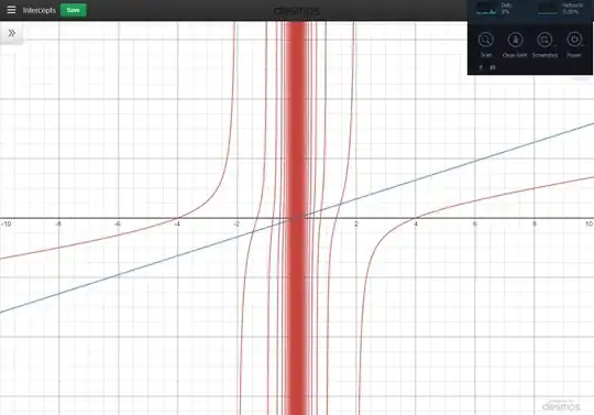

Looking at a graph, we have an infinite amount of interception points:
Indeed, the behavior of the $\tan$ around $x=0$ is not very good for most numerical methods.
