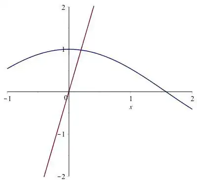

Study $f:x\mapsto \cos x - 5x$ :
Its derivative is $f':x\mapsto -\sin x - 5 \lt0$ thus $f$ is decreasing over $\Bbb R$, $f(0) = 1\gt0$ and $f({\pi\over2}) = -5{\pi\over2}\lt0$ thus there is only one solution over $\Bbb R$ and it is located in $[0, {\pi\over2}]$.
However there is no closed form of this root.

Here are graphs for $\cos x$ and $5x$. We can see there is only one crossing point where $\cos x = 5x$, right?
