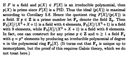

I don't understand the three claims that some $F_a[X]/(p(x))$ has some $n$ elements in the following text (from Adkins' Algebra):
For example Why $F_2[X]/(X^2+X+1)$ has $4$ elements and what are those? I think that since $(X^2+X+1)$ is an ideal so $F_2[X]={\{X^2+X+1}\}F_2[X]=(X^2+X+1)$ so $F_2[X]/(X^2+X+1)$ is singleton?
Same as the other two: Why $F_3[X]/(X^2+1)$ (or $F_2[X]/(X^3+X+1)$) has $9$ (or $8$) elements and what are those?
Text is elementry itself but here it doesn't explain them well. Simple detailed explanation would be much apprecaited.
