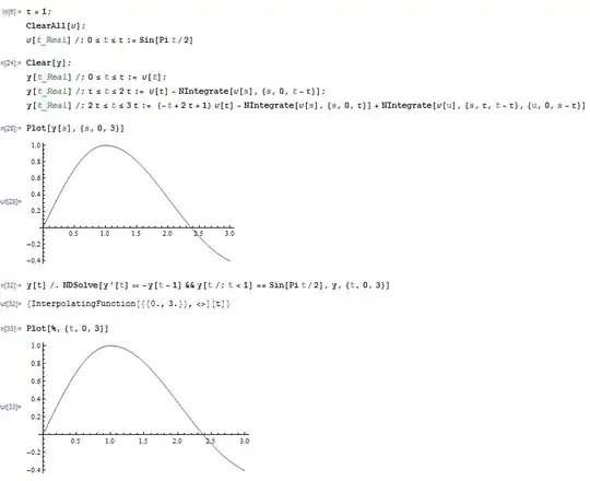

First of all, let's turns into a delayed form. Let $g(x) = f(-x)$, then we have: $$ g'(x) = -g(x-1) $$ Therefore consider more general equation $y'(t) = -y(t-\tau)$, and initial condition $y(t) = \upsilon(t)$ for $0<t<\tau$. Then, for $\tau < t < 2 \tau$, $$ y(t) = \upsilon(\tau) - \int_\tau^t y(s-\tau) \mathrm{d}s = \upsilon(\tau)- \int_\tau^t \upsilon(s-\tau) \mathrm{d}s = \upsilon(\tau) - \int_0^{t-\tau} \upsilon(s) \mathrm{d}s $$ for $2 \tau < t <3 \tau$: $$ y(t) = y(2 \tau) - \int_{\tau}^{t-\tau} y(s) \mathrm{d} s = \upsilon(\tau)-\int_0^\tau \upsilon(s) \mathrm{d}s - (t-2 \tau) \upsilon(\tau) + \int_\tau^{t-\tau} \int_{0}^{s-\tau} \upsilon(u) \mathrm{d} u $$ and so on.
Here is an implementation of this idea in Mathematica, and comparison with built-in delayed ODE solver: enter image description here

  • 70,631
  • I don't think this resolves the question of which initial conditions lead to full solutions. Obviously $v$ being a constant function other than zero does not. – Ben Millwood Sep 20 '12 at 13:58
  • @BenMillwood The full solution has the initial condition function unspecified, i.e. the solution space is not finite-dimensional, like in the non-delayed counterpart $y^\prime(x) = -y(x)$. – Sasha Sep 20 '12 at 14:01
  • right, but only some initial condition functions are viable, and I think that in order to claim a general solution you'd have to identify that set. – Ben Millwood Sep 20 '12 at 14:20
