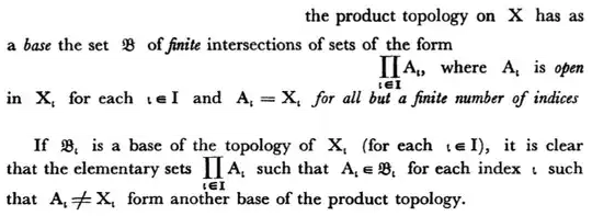

  • Dear Mr. van der Zypen, you've accepted Eric Wofsey's answer, so I imagine you understand it. Would you be so kind as to explain to me a couple points that I don't understand in Mr. Wofsey's answer? 1. At the end of the first paragraph he wrote: "These Boolean combinations will still form a countable set." I don't understand why this is so. If you start off with an infinitely countable set, isn't the set of all finite linear combinations of members of this set potentially non-countable? – Evan Aad Oct 26 '16 at 12:59
  • I don't understand the last sentence of the second paragraph: "for any function $f:S\rightarrow2$ there is a Boolean combination of the $e_{\mathbb{N}}(n)$ that agrees with $f$ on $S$." Why is this the case? Thanks.
