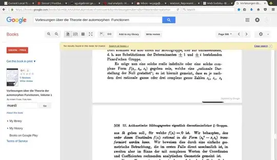

It took me three steps to prove this, so I will present it that way. The first statement of this that I know is pages 507-508 of Fricke Klein 1897
This is also on page 303 of Cassels but is not part of the online preview. ADDED it is also the intent of Example 1 on page 28, which refers to Lemma 2.1 and Corollary 1 on page 15 (by way of a hint for the exercise).
