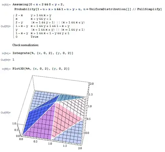

Gives $0<x<2$ and $0<y<2$, we first compute $F_{X,Y}(x,y)$: $$\begin{eqnarray} F_{X,Y}(x,y) &=& \mathbb{P}\left(X \leqslant x, Y \leqslant y\right) = \mathbb{P}\left(U+V \leqslant x, U+W \leqslant y\right) = \mathbb{E}\left(\mathbb{P}\left(U+V \leqslant x, U+W \leqslant y|U\right)\right)\\ &=& \mathbb{E}\left(F_V(x-U)F_W(y-U)\right) = \mathbb{E}\left(\min(1, \max(x-U,0))\min(1, \max(y-U,0))\right) \end{eqnarray} $$ The pdf, being a derivative of the cdf, will then read: $$ f_{X,Y}(x,y) = \frac{\partial}{\partial x} \frac{\partial}{\partial y} F_{X,Y}(x,y) = \mathbb{E}\left( [1+U>x>U] [1+U > y>U] \right) = \mathbb{P}\left(U < x < 1+U \land U < y<1+U\right) $$ The evaluation of the latter expectation is straightforward but tedious, so I asked Mathematica for help: enter image description here

  • Wonderful! I just have a bit of trouble following how you calculate the partial derivatives of the CDF (keeping things so neat!) – em70 Sep 15 '12 at 13:57
    Well, you could have done as $$\partial_x \partial_y \mathbb{E}\left(F_V(x-U) F_W(y-U) \right) = \mathbb{E}\left(f_V(x-U) f_W(y-U) \right) = \mathbb{E}\left([0<x-U<1] \cdot [0<y-U<1 ] \right) $$ – Sasha Sep 15 '12 at 14:11
