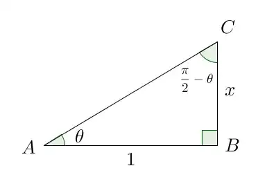

Start with a right-angled triangle $ABC$, as shown below.
Looking at the angle $\angle BAC$ we have $\tan \theta = \frac{x}{1}$.
Looking at the angle $\angle ACB$ we have $\tan(\frac{1}{2}\pi-\theta)=\frac{1}{x}$.
Hence $\theta = \arctan x$ and $\frac{1}{2}\pi-\theta=\arctan \frac{1}{x}$, and so $$\arctan x + \arctan \tfrac{1}{x} = \tfrac{1}{2}\pi$$
