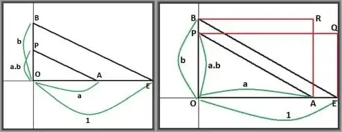

Here is the construction by Descartes (figure on the left):
After defining a unit OE and the lengths (= reals) OA and OB, in order to define the product OP, it is necessary to draw a line OP parallel to EB.
Of course, there is a relationship between Euclid's and Descartes' construction: the areas of OARB and OEQP are equal.

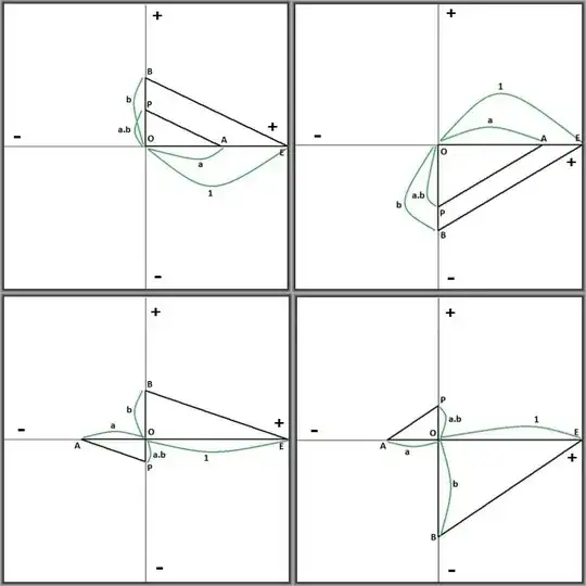

It should be noted though, that negative numbers are impossible within Euclid's system, while the (Des)Cartesian coordinate system ensures that they can be properly represented geometrically.
Why is negative times negative = positive?
Descartes' Euclidean Geometrical Algebra gives us a nice proof without words :
Parallel lines seem to be essential all over the place, thus requiring an Euclidean geometry. And doesn't our common Equals sign not just represent two parallel $=$ lines?
