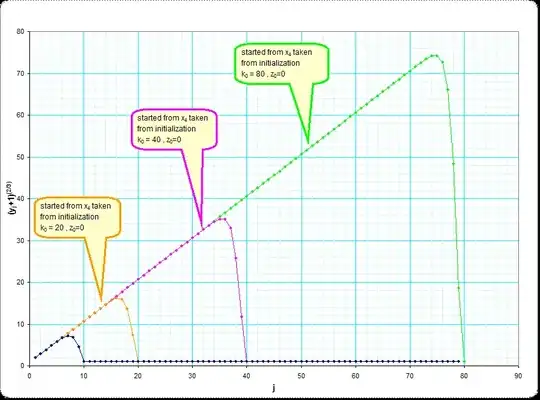

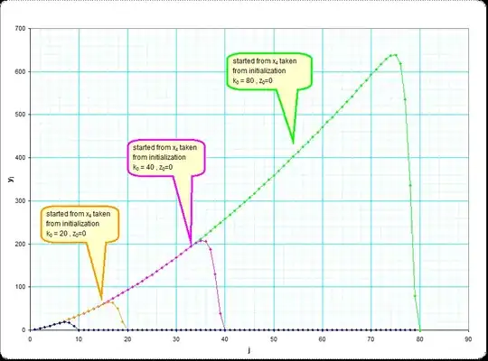

Here are two pictures illustrating the approximation to the asymptotic infinite sequence of $y_j$.
The original sequences taken from $k=10,k=20,k=40,k=80,z_0=0$
and the linearization using the $(2/3)$-roots $w_j=\sqrt[2/3]{y_j+1}$ image2
The linearity in $w_j$ and in the latter picture surprise me much . Extrapolated to high starting values of $z_j$ (ideally infinity) and the coefficient $k_j$ at $k_j \cdot \sqrt[3]{1+z_j}$ it seems, that the iteration smoothes the ratio between $k_j$ and $z_j$ such that $k_j = \lfloor (z_j+1)^{2/3} \rfloor$ and if this ratio has been approached by the iterations for the evaluation of the iterated- root-expression we find that th $k_j$ decrease in steps of $-1$. So we might say, that using any $z_0$ the sequence of evaluations is equivalent to the iterated radical $$ \sqrt[3] {1+ 2\sqrt[3] {1+ 3\sqrt[3]{1+... \lfloor (1+z_j)^{2/3} \rfloor \sqrt[3] {1+ z_j} } }} \tag3 $$
