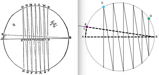

Vincent Julien is the editor of the book Seventeenth-Century Indivisibles Revisited , and it seems that he also wrote pp.192~194 that is relevant to our discussion. It took a surprising amount of effort to understand his description (of how/why Roberval's derivation is valid).
Below is my translation of Julien's translation of Roberval's method.
The left figure below is Roberval's original diagram in Traité des Indivisibles, reprinted on p.193 in Julien' book. The right figure is my rendition of the left, somewhat exaggerated for clarity. I will follow Roberval's poor choice of labels.
Left: Roberval's original diagram.  Right: remake with GeoGebra.
Consider a circle with radius $r$. Draw the horizontal diameter $\overline{AB}$ so that there's the upper semicircle and the lower semicircle.
On the upper semicircle, select an arbitrary starting point $D$ (green) and an arbitrary end point $C$ (blue).
In our modern language, denote the (central) angles of these points as $\theta_D$ and $\theta_C$, where $0 < \theta_D < \theta_C < \pi$. The objective is to show $$ \int_{\theta_D}^{ \theta_C} \sin\theta \,\mathrm{d}\theta = \cos\theta_D - \cos\theta_C$$
Split the big arc $\widetilde{DC}$ into $n$ smaller arcs. Construct this common arc size as $\widetilde{A8}$, where point `$8$' (purple) is the right angle of the prototype triangle (thick dashed) $\triangle A8B$.
In our notation, this is equivalent to defining $$\widetilde{A8} \equiv r\Delta\theta~, \qquad \Delta\theta \equiv \frac{ \theta_c - \theta_d}n$$ This basic arc unit $\Delta\theta$ will be taken to the limit $n \to \infty$ to have a Riemann sum with $\Delta\theta \to \mathrm{d}\theta$.

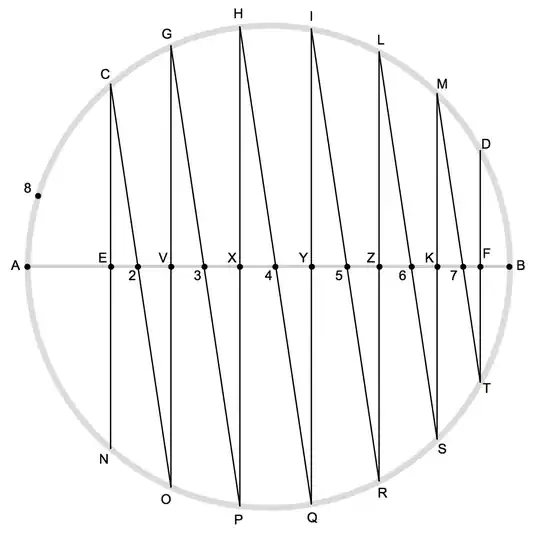

To be explicit, the figure below is the drastically exaggerated diagram of such construct: $\widetilde{CG} = \widetilde{GH} = \cdots = \widetilde{LM} = \widetilde{MD} = \color{purple}{\widetilde{A8} = \Delta \theta}$
The points in the lower semicircle (left to right: $N,O,P,Q,R,S,T$) are mirror images of the points in the upper half ($C,G,H,I,L,M,D$), and the lines connecting them are vertical.
All the "sharp angles" are of the same size, because by construction they are inscribed angles of the same arc. All the triangles in the upper and lower half are similar to the prototype $\triangle A8B$. Namely, from left to right: $$\triangle 2EC \sim \triangle 2VO \sim\triangle 3VG \sim \triangle 3XP \sim \cdots \sim \triangle 7KM \sim \triangle 7FT \color{purple}{\sim \triangle A8B}$$
Exaggerated diagram of circle with many similar triangles
$\color{magenta}{\text{Given the construct above, here comes the derivation:}}$
\begin{align*} &\text{For the prototype:}\qquad \frac{ 2r }{ r\Delta\theta } = \frac{ \overline{AB} }{ \widetilde{8A} } = \frac{ \text{hypotenuse} }{ \text{tiny arc} } \approx \frac{ \text{long leg} }{ \text{tiny leg} }\\ &\begin{aligned} \text{For any triangle inside:}\qquad \frac{ \text{long leg} }{ \text{tiny leg} } &= \frac{ \text{vertical leg} }{ \text{horizontal leg} } \\ &= \frac{ | \text{sine} | }{ \text{horizontal segment along the diameter} } \end{aligned} \end{align*} Since the ratio "long leg/ tiny leg" is the same for each of the triangles inside ($\triangle 2EC \ldots \triangle 7FT$), we can add the numerators in each of the fractions together, divide this by the sum of the denominators, and still end up with the same ratio: \begin{align*} \frac{ 2r }{ r\Delta\theta } &\approx \frac{ \text{sum of lengths of upper and lower sines} }{ \text{ sum of legs} } \notag \\ &= \frac{ 2 \sum\text{upper sines} }{ \overline{EF} } \tag*{Eq.(1)} \label{Eq01} \end{align*}
On the other hand, we have an exact ratio from a totally separate consideration. $$ \frac{ r }{ r\Delta\theta } = \frac{ r }{ \widetilde{A8} } = \frac{ r }{ \widetilde{CG} } = \frac{ r }{ \widetilde{GH} } = \ldots \quad\qquad \text{$\because$ each arc is the same as $\widetilde{A8}$ by definition} $$ Again, the ratio remains the same when the numerators and denominators are summed respectively: $$ \frac{ r }{ r\Delta\theta } = \frac{ \sum r }{ \sum \text{arcs} } = \frac{ n \cdot r }{ \widetilde{CD} } \tag*{Eq.(2)} \label{Eq02} $$ Putting the approximation \ref{Eq01} and the exact \ref{Eq02} together we have $$ \frac{ \sum\text{upper sines} }{ \overline{EF} } \approx \frac{ r }{ r\Delta\theta } = \frac{ nr }{ \widetilde{CD} } \qquad \implies \quad \frac{ \sum\text{upper sines} }{ nr } \approx \frac{ \overline{EF} }{ \widetilde{CD} } \tag*{Eq.(3)} \label{Eq03} $$ As quoted by Julien, Roberval basically stopped here.
In modern notation, we have $\overline{EF} = r | \cos\theta_c - \cos\theta_d |~$ and $~\widetilde{CD} = r(\theta_c - \theta_d)$, and \ref{Eq03} can be rewritten into the desired familiar form: \begin{align*} &\frac{ \sum\text{upper sines} \cdot (\theta_c - \theta_d ) / n }{ r (\theta_c - \theta_d) } \approx \frac{ EF }{ \widetilde{CD} } = \frac{ -r ( \cos\theta_c - \cos\theta_d ) }{ r(\theta_c - \theta_d) } \\ &\implies \sum \mathrm{sine} \cdot \Delta\theta \approx -r ( \cos\theta_c - \cos\theta_d ) \end{align*}
This is where Vincent Julien confirmed on p.194 that "the claim is valid", referring to an earlier work by another historian named Walker stating that Roberval derived $\int \sin\theta \,\mathrm{d}\theta = - \cos\theta$.
