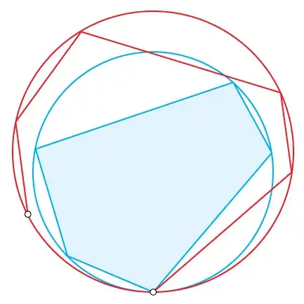

Two suggestions:
(1) Use the "2-kinks" theorem to form a triangle from your lengths. (Computational Geometry in C, p.330). Then several angles are $180^\circ$, and three are triangle angles.
(2) Form a cyclic polygon from your lengths by shrinking the radius of a circle until your lengths close to a polygon:
See this MSE posting for cyclic polygon calculations, or the reference by @hardmath (in a comment) to another MSE posting on cyclic polygons.
