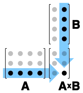

Perhaps the best way to look at matrix multiplication when you want to compute a product by hand is as follows:
(See also the comparable illustration on the wikipedia page.)
When you're computing by hand, just bump the second matrix up to make room for the product in the lower-right corner.
Note that the upper-left corner must be a square, which re-confirms the requirement that "columns of $A$" = "rows of $B$"; moreover, you can see that $A\times B$ inherits its row dimension from $A$ and its column dimension from $B$.
