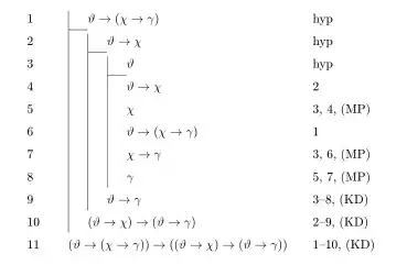

I have come across proofs using a notation with boxes (Logic in Computer Science by Huth and Ryan), where each assumption is inside its own box:
Picture 1

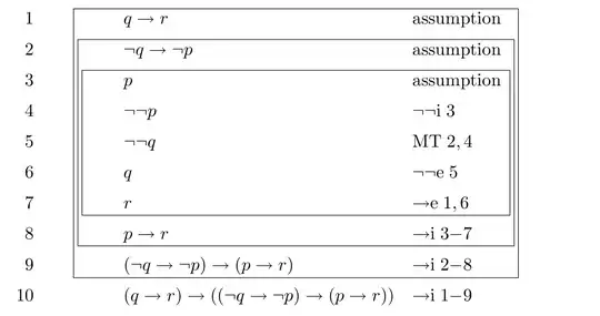

I would now like to write these proofs using Fitch notation, but I am unable to understand how to do that. I have given it a try (see below), but I am not sure this is correct.
Picture 2
I have looked around quite a lot for a "Fitch notation for dummies" but my knowledge within the field of logical proofs is sparse and I have yet to find anything helpful.
I would greatly appreciate any help in the matter of translating "boxes to Fitch".

Your answer is correct. Actually it is easier just to use your own logical reasoning to write a proof directly in Fitch-style notation. The fundamental requirement is that every syntactic structure involving a $\huge\vdash$ is specifying a subcontext, where what is on top specifies the subcontext, and what is below is what you derive within that subcontext. So for propositional logic every 'assumption' corresponds to creating a new subcontext in which the assumption is true. And you can see easily why the rules of natural deduction are sound, because for example the [$\to$ intro] and [$\to$ elim] rules together capture the meaning of implication because they make it so that, within any context, we have "$A \to B$" is derivable iff "$\begin{array}{|l}A \\\hline B\end{array}$" is derivable.

Here is an example of Fitch notation I know, perhaps it is what you meant: enter image description here
But personally I think it is irrelevant which of these notations (Fitch, yours, or Huth and Ryan) you use. They all seem nice and clear to me (they are basically the same). In particular, the translation you propose seems perfectly fine to me.
  • Thank you for your input. From your example I presume that the correct way to use the horizontal lines is to show where the assumption is. You then continue as usual. Is this correct? I am glad to see that you think my way is clear, I am however looking for a more definitive answer regarding if there is such a thing as a correct way to do it. Please see my updated post. – GLaDER Aug 31 '16 at 12:10

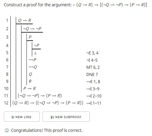

Here is a proof showing how your proof would look in this Fitch-style proof checker:
The proof checker link and associated logic textbook are listed below.
Kevin Klement's JavaScript/PHP Fitch-style natural deduction proof editor and checker http://proofs.openlogicproject.org/
P. D. Magnus, Tim Button with additions by J. Robert Loftis remixed and revised by Aaron Thomas-Bolduc, Richard Zach, forallx Calgary Remix: An Introduction to Formal Logic, Fall 2019. http://forallx.openlogicproject.org/forallxyyc.pdf
Frank Hubeny
