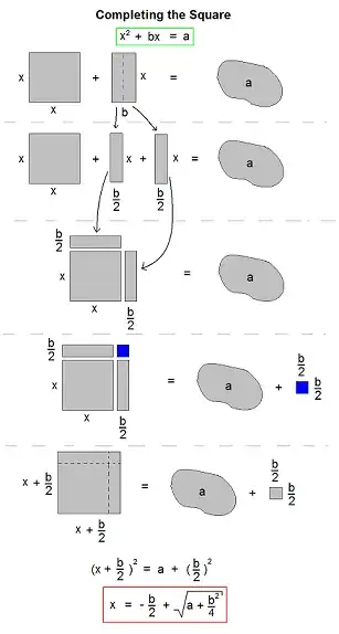

I don't know for sure, but I imagine it was first found by thinking about rearranging squares and rectangles, as in the following image:
