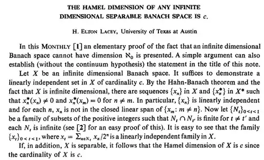

I was trying to show this result. I have seen proofs that show that the dimension is at least $\mathfrak{c}$, however, I'm unable to prove that it is exactly $\mathfrak{c}$. The last line of this article is unclear. How does separability imply that dimension is $\mathfrak{c}$? enter image description here

If $X$ is separable, it has a countable dense subset $A$. Every point of $X$ is a limit of some sequence in $A$, and there are only $|A|^{|\mathbb{N}|}=\mathfrak{c}$ different sequences in $A$. So $|X|\leq\mathfrak{c}$. A Hamel basis for $X$ is a subset of $X$, and so any Hamel basis has at most $\mathfrak{c}$ elements.
