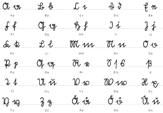

31
The corresponding handwritten script is Sütterlinschrift (Sütterlin script). This chart (which I’ve now reproduced here) clearly shows you the letter forms.
Added 20 October 2022: Uppercase Sütterlin letters that I have seen used to write mathematics at the blackboard, in some cases by Jerry Keisler, include at least $A,B,G,M,N$, and $U$.
Brian M. Scott
  • 616,228
    With all due respect, this is barely intelligible! The "C" looks like a calligraphic "L", the "E" looks like an "f", the "X" looks like a calligraphic "H", etc. – Detached Laconian Sep 14 '18 at 20:37
    @DetachedLaconian: That is largely because you’re so familiar with a very different script based on a very different kind of book hand. (And the upper-case X looks very much like a standard lower-case x in much British handwriting.) – Brian M. Scott Aug 25 '20 at 18:29
