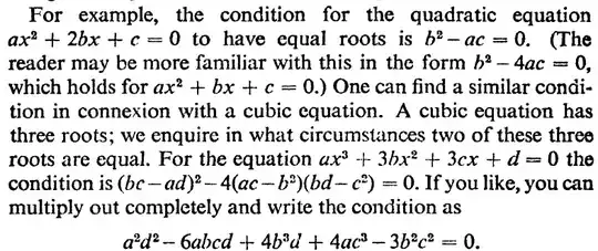

I'm reading Sawyer's Prelude to Mathematics, here:
Book's excerpt
I can't understand what's the meaning and application of "condition" here. Also when he gives the example on the cubic equation, stating that the condition is: $$(bc-ad)^2-4(ac-b^2)(bd-c^2)=0$$
I can understand that it is $b^2-4ac=0$ (I hope I'm right with this), I just have no idea on where is the order of the variables inside the parentheses coming from.

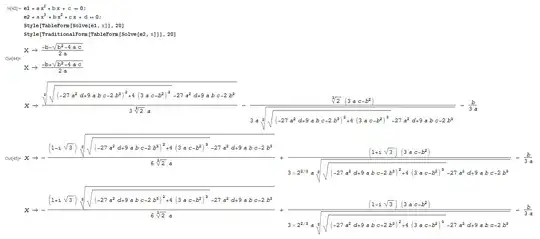

Then I thought about searching it on the solutions for cubic equations with some help of Mathematica, but I got nothing that was similar to:
or:
$$a^2d^2-6abcd+4b^3d+4ac^3-3b^2c^2=0$$
With no success. You can see it here:

  • He writes $ax^2+2bx+c=0$ which completing the square gives $a(x+b/a)^2+c-ab^2/a^2=0$ for this to be a perfect square we need $c-b^2/a=0$ or simply $ac-b^2=0$. I guess you understand this part already. I'll have to think about the other part. – James S. Cook Sep 01 '12 at 19:07

  • Read the few words just before the condition. This tells where the constants $a$, $b$, $c$, and $d$ come from. As the few sentences before that describe, the author starts by talking about a quadratic equation then changes to talking about a cubic equation. – Code-Guru Sep 01 '12 at 19:14
