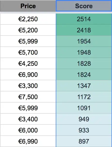

Now, I have an ordered list where items are filtered from descending score. All parameters are set in stone, but price might vary; each item's price could potentially be discussed.
Ordered item list by score

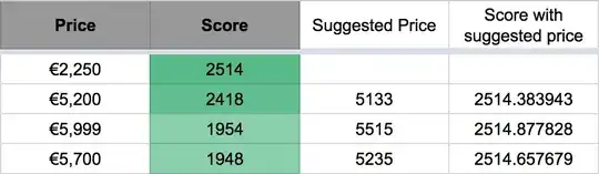

What I'm trying to do is to suggest a bargained price for each item so it matches the item with the highest score.
For the moment, those 3 suggested prices have been manually found (and aren't very accurate of course).
The idea is that basically, an item might be worth giving priority over a higher ranked item if we can manage to bargain a good price. We're on the buyer side, so better score means cheaper price.
So the final question is: what equation(s) do I need to come up with to find a price whose score would match the best score ?

Thus if we wish to have $suggestedscore_i=bestscore$ then we should change $price_i$ to $suggestedprice_i$ as follows:
$$bestscore=suggestedscore_i = s_i\cdot f\left(\frac{threshold}{suggestedprice_i }\right).$$
Let $g$ be the inverse function for $f$, that is
$$g(y)=\cases{ y , \mbox{if }y\le 1,\\ y^{1/5}, \mbox{if }y\ge 1 }.$$
Then $g\circ f(x)=f\circ g(x)=x$ for each $x\ge 0$ and the above equality implies
$$suggestedprice_i=\frac{threshold}{g\left(\frac{bestscore}{s_i}\right)}.$$
In other words,
$$ suggestedprice_i =\cases{ threshold\cdot \frac{s_i}{bestscore} , \mbox{if }s_i\ge bestscore,\\ threshold\cdot\left(\frac{s_i}{bestscore}\right)^{1/5}, \mbox{if } s_i \le bestscore }.$$

    For some reason, doing that actually raises the suggested prices for all objects except the one with the best score... Since I'm doing it in Google Spreadsheets, here's how I implemented it: suggested_price = G2*((MAX(N:N)/N2)^(2/3) where G2 is the item's price, MAX(N:N) is the best score and N2 is the item's current score. – Skwiggs Jul 25 '17 at 15:20
  • The reason of the price rising is that the price is multiplied by a positive power of best_score/score[i], which is at least $1$. – Alex Ravsky Jul 25 '17 at 16:16
  • But that lowers the score actually... Higher score is achieved with a cheaper price, not the opposite. The way I calculate the composite for the price is the following: If the price is higher than a specific threshold, return less than 1, otherwise return more (so that the price actually divides the total score if it's too high). I don't know, maybe I need to explain a bit more what each of those parameters are and how they're calculated ? – Skwiggs Jul 25 '17 at 20:41
  • I've managed to solve it by inversing the division. I'm dividing the current score by the highest score which will never be higher than 1. This now works for almost all offers, but somehow some have gone to ridiculously low prices and the score shot up through the roof. – Skwiggs Jul 25 '17 at 20:51
  • Ok sorry, last comment; I noticed that this happens only for items whose price is above my threshold. Makes sense as the composite for the price is then put to the 5th exponent. – Skwiggs Jul 25 '17 at 22:09
  • @Skwiggs “Higher score is achieved with a cheaper price, not the opposite”. According to the formula score = Param1 * Param2 * Param3 * Param4 * price the opposite holds, because score is proportional to price. – Alex Ravsky Jul 26 '17 at 01:39
  • yes sorry my bad, I withheld some information for you to be able to see the full picture. I've edited the question to make it a bit more clear on how I'm calculating the score and the parameters – Skwiggs Jul 26 '17 at 08:34
  • @Skwiggs OK, I edited my answer. – Alex Ravsky Jul 26 '17 at 11:27
  • what exactly is $s_i$ ? I couldn't really understand how I calculate it from your answer – Skwiggs Jul 27 '17 at 16:11
  • @Skwiggs $s_i$ is a multiplier for $score_i$, which is set in stone. For instance, for the example from the beginning of your question, $s_i$=Param1 * Param2 * Param3 * Param4. – Alex Ravsky Jul 27 '17 at 16:38
    Ok got you. This mostly works now, but since some of those parameters can be inferior to $1$, there's still some cases where this formula doesn't work. They could potentially all be inferior to $1$ as a matter of fact. How do I translate that into the formula ? Sorry for distilling information so sparsely, I just have no idea of what I'm doing.... – Skwiggs Jul 28 '17 at 09:08
  • @Skwiggs Can you provide an example of parameters for which the formula doesn't work? – Alex Ravsky Jul 28 '17 at 14:55
  • Sure: $2.00 * 2.06 * 220.00 * 0.34 * 1.47 = 453$, where $price=3900$, $suggestedPrice=683$ and $score_{suggestedPrice}=3213$... This time Param4 is inferior to $1$. Another one with a different parameter being $<1$: $2.00 * 1.38 * 430.78 * 1.96 * 0.19 = 443$, where $price=6950$, $suggestedPrice=5028$ and $score_{suggestedPrice}=3213$ again. Not sure what's going on as this time it's only the price that's being $<1$ :/ – Skwiggs Jul 28 '17 at 20:40
  • @Skwiggs Sorry for the delay with the answer, but I cannot say what is going wrong with these examples. My formulas don’t depend whether are single parameters bigger or less than $1$, they depend only on their product $s_i$. And what is wrong with the examples: in both cases $suggestedPrice$ is less than $price$ and $score_{suggestedPrice}$ are equal (I guess they match the $bestscore$). Isn’t this the aim for which you have asked? – Alex Ravsky Aug 19 '17 at 07:28
