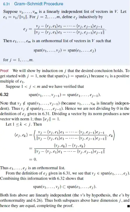

I am reading the following proof in the book Linear Algebra Done Right. But I don't understand what induction on $j$ means here! I suppose the author means induction on $m$. However, all the proof is talking about $j$ and I don't think this is a typo!
Does induction on $j$ makes sense, here? I mean what is the variable of induction? I am confused!
My Thought
What is the index $j$ that the author is talking about in the proof? Is it the same as mentioned in the theorem? If the author is assuming that the theorem is true for $v_1,...,v_k, 1 \le k \le j$ and then wants to prove it for $v_1,...,v_j,v_{j+1}$ while $j$ remain in $1 \le j \le m-1$, then the proof suffers from abuse of notation so badly.
Induction on $j$ seems meaningless to me! Because theorem is an expression which depends on $m$ (the length of the list of linearly independent vectors) not $j$! In other words, we want to see that Theorem is true for all $m \ge 2$ or not!
$1$- If I was going to prove the theorem by myself then I would change the last line of theorem by
$$\text{span}(v_1,...,v_m)=\text{span}(e_1,...,e_m)$$
and then do an induction on $m$.
$2$- I also think that we can prove the theorem by induction on $m$ in the original form. It is stronger than the case $1$ above?
  • There's no typo. In this context, $m$ is a parameter, and the construction of an orthonormal basis from s system of linearly independent vectors is a (finite) recursive procedure. – Bernard Aug 16 '16 at 13:26
    The induction is on $j$ where $1\le j\le m$. As you rightly observe though, the the condition of finiteness is unnecessary, so that, for example, this procedure applies to Hilbert Spaces also. – Matematleta Aug 16 '16 at 13:34
  • @Bernard: So the induction is on $j$ or $m$? – Hosein Rahnama Aug 16 '16 at 13:40
  • It's on $j$ indeed. – Bernard Aug 16 '16 at 13:41
  • @Bernard: I still think it does not make sense to say induction is on $j$! Did you read the theorem and proof carefully? Maybe I am getting myself confused! It should be on $m$! – Hosein Rahnama Aug 16 '16 at 13:44
  • For me it's a fine proof. It says you start with one unit vector $e_1$. Then you construct a second unit vector $e_2$, orthogonal to the first. The again, you construct a third unit vector $e_3$, orthogonal to the first two. The induction part consists in showing that, as long as you do not have an orthonormal list of length $m$, you can continue the procedure. What does not make sense in this? – Bernard Aug 16 '16 at 13:50
  • @Bernard: Would you please take a look at the lines I added to the question. – Hosein Rahnama Aug 16 '16 at 14:15
    I see. To prove the theorem, you have to prove that for all $j$, the span of $(v_1,\dots,v_j)$ is the same as the span of $(e_1, \dots, e_j)$. This is stronger than your conclusion. – Bernard Aug 16 '16 at 14:30
  • @Bernard: OK, I got it. :) Many thanks. Would you please write an answer so that I can accept it. Also, the question does not remain unanswered. :) – Hosein Rahnama Aug 16 '16 at 14:48

  • @Chilango: What is the index $j$ that the author is talking about in the proof? Is it the same as mentioned in the theorem? If the author is assuming that the theorem is true for $v_1,...,v_k, 1 \le k \le j$ and then wants to prove it for $v_1,...,v_j,v_{j+1}$ while $j$ remain in $1 \le j \le m-1$, then the proof suffers from abuse of notation so badly. Also, proving that $<e_j,e_k>=0$ is not correct! – Hosein Rahnama Aug 17 '16 at 08:10

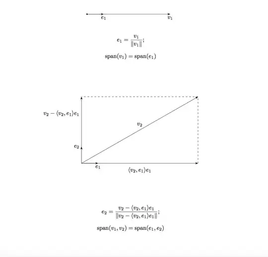

As pointed out in the comments, the proof in the book is correct; in fact, the statement is exactly what we wanted: $\text{span}(v_1)=\text{span}(e_1)$, $\text{span}(v_1,v_2)=\text{span}(e_1,e_2)$, $\text{span}(v_1,v_2,v_3)=\text{span}(e_1,e_2,e_3)$, and go on in general for an infinite list: $\text{span}(v_1,v_2,\ldots,v_n,\ldots)=\text{span}(e_1,e_2,e_3,\ldots,e_n,\ldots)$. Note we need this for the proof of $6.37$ on page 186 of the book:

The proof of $6.31$ has no problem. The following visualization should clarify the confusion:
Or just write out the first few steps explicitly:
$j=1$:
$\text{span}(v_1)=\text{span}(e_1)$ is simple;
$j=2$:
We have $v_2\notin\text{span}(v_1)$.
Let $1\leq k<2$, so $k=1$.
$\displaystyle\langle e_2,e_1\rangle=\frac{\langle v_2, e_1\rangle-\langle v_2,e_1\rangle}{\|v_2-\langle v_2,e_1\rangle e_1\|}=0$, so $e_1,e_2$ are orthonormal. From the picture above, it is clear that $\text{span}(v_1,v_2)=\text{span}(e_1,e_2)$.
$j=3$:
We have $v_3\notin\text{span}(v_1,v_2)$.
$\displaystyle e_3=\frac{v_3-\langle v_3, e_1\rangle e_1-\langle v_3,e_2\rangle e_2}{\|v_3-\langle v_3, e_1\rangle e_1-\langle v_3,e_2\rangle e_2\|}$
Let $1\leq k<3$, so $k=1,2$.
$\displaystyle\langle e_3,e_1\rangle=\frac{\langle v_3,e_1\rangle-\langle v_3,e_1\rangle-\langle v_3,e_2\rangle\cdot0}{\|\cdots\|}=0$
$\displaystyle\langle e_3,e_2\rangle=\frac{\langle v_3,e_2\rangle-\langle v_3,e_1\rangle\cdot0-\langle v_3,e_2\rangle}{\|\cdots\|}=0$
So $e_1,e_2,e_3$ are orthonormal.
$\vdots$
When things go too abstract in this book, it is often helpful to draw some pictures, play with $2\times 2$ matrices, or resort to other less "theoretical" books. By the way, I like this book very much.
