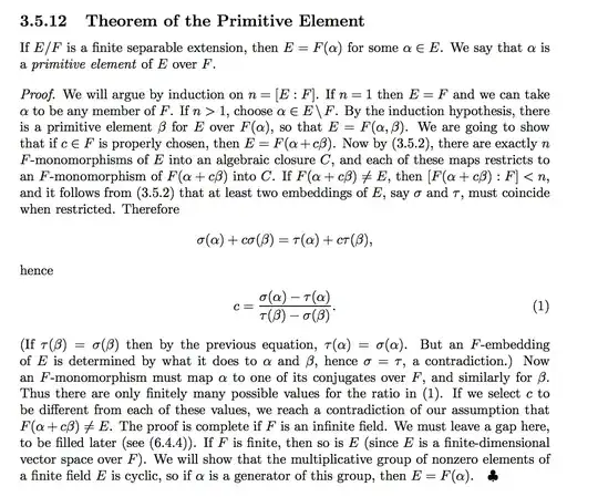

BUT I want to show this using The Theorem of the Primitive Element,
So I have to verify that $c$ cannot be $1$ and I need the $\mathbf Q$-monomorphisms, what are these ?

    The primitive element theorem does not help at all in demonstrating that one particular element is a primitive element; the theorem just says that at least one primitive element exists. – Zev Chonoles Aug 11 '16 at 17:01
