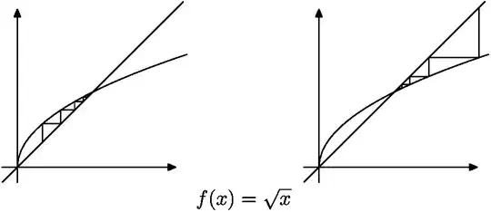

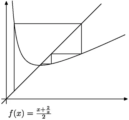

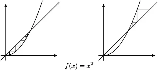

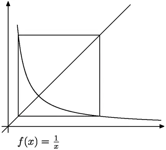

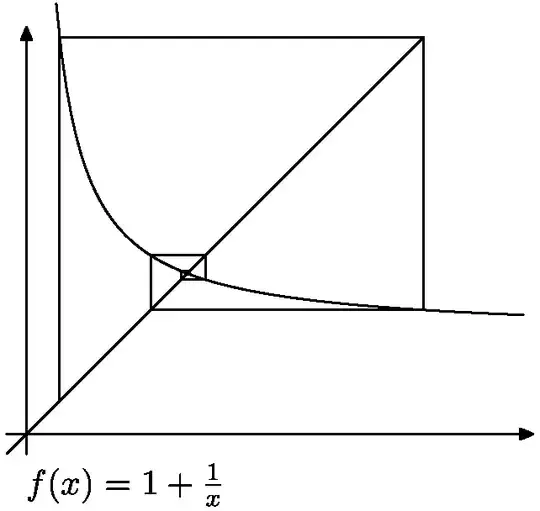

Fixed point iterations can be illustrated nicely with cobweb plots. The plots corresponding to functions I mentioned above are shown below. More similar illustration can be found here or elsewhere.
From the pictures it seems that the local behavior of $f'(x)$ might be enough to describe the behavior of the iterated sequence. (Whether it converges or not, whether the convergence is monotone, etc.) At least in the case that $|f'(x)|\ne1$ in some interval around the solution.
  • What can be said about the sequence given by $x_{n+1}=f(x_n)$ if we have information about the values of $f'(x)$ close to the fixed point of $f$?

Illustration of Babylonian method for $f(x)=\frac12(x+\frac2x)$.
Iterations of f(x)=(x+2/x)/2
Illustration for iterations of $f(x)=1+\frac1x$
Iterations of f(x)=1+1/x
Iterations of $f(x)=\sqrt x$
Iteratrions of sqrt(x)
Iterations of $f(x)=\frac1x$
Iterations of f(x)=1/x
Iterations of $f(x)=x^2$
Iterations of f(x)=x^2
