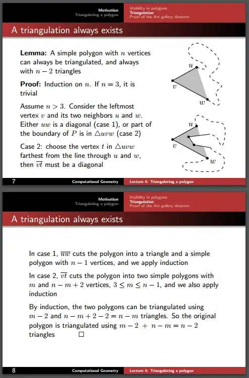

I Found this .....
Here http://www.cs.uu.nl/docs/vakken/ga/slides3.pdf The work seems to be authored by prof. dr. M.J. van Kreveld and dr. W.G. van Toll at Universiteit Utrecht.
It's not hard to add the details
  1. If there is a boundary point inside UVW (or on UW) then there nust be a vertex inside UVW (or on UW). Otherwise the side that contains the point would extend to intersect UV or VW or U or W any of which contradicts the polygon being simple.
  2. Having chosen the vertex furthest from UW (any of them if there is more than one equidistant) construct a line through it parallel to UW intersecting UV at X and VW at Y. If there were a boundary point in VXY then by the same argument as (1) there would need to be a vertex. This would contradict the chosen vertex being furthest from UW. Since the inside of VXY is therefore clear of boundary points then a line from V to the chosen vertex does not cross the boundary.
