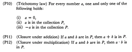

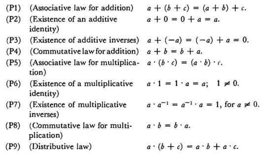

Prove $x^n - y^n = (x - y)(x^{n-1}+x^{n-2}y+ \cdots + xy^{n-2}+y^{n-1})$ using only the following properties:
It's easy enough for me to use P9 to expand the right-hand side:
