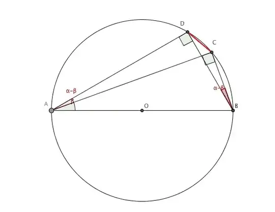

Taking @SiongthyeGoh's comment, in the above picture, $AE=1$, $\angle BAE=x$, $\angle BAC=\beta$, and $\angle BAD=\alpha$.
It follows that $DE=\sin(x+\alpha)$ and $CE=\sin(x+\beta)$. Applying the cosine theorem to $\triangle DCE$, the given expression is equal to $DC^2$, hence is a constant.
