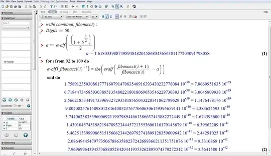

We denote the $n$th term of Fibonacci number with $F_n$. Assume that $\alpha=\frac{1+\sqrt{5}}{2}$. With simulation, I found the following relation between Fibonacci number and the golden section $$ \mid \frac{F_{n+1}}{F_{n}}-\alpha\mid \, \approx \, \frac{1}{(F_n)^2}~. $$ Is there a analytical method that we can proof the mentioned formula. I would greatly appreciate for any suggestions.
Maple simulation
