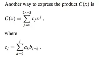

I will try to start from the simplest case possible and then build up to your situation, in order to hopefully develop some intuition for the notion of convolution.
Convolution essentially generalizes the process of calculating the coefficients of the product of two polynomials.
See for example here: Multiplying polynomial coefficients. This also comes up in the context of the Discrete Fourier Transform. If we have $C(x)=A(x)B(x)$, with $A(x), B(x)$ polynomials, we have:  The image is from Cormen et al, Introduction to Algorithms, p. 899.
This type of operation also becomes necessary when calculating the probability distributions of discrete random variables. In fact, this type of formula allows us to prove that the sum of independent Bernoulli random variables is binomially distributed.
