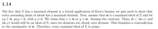

Here is one proof that I think is flawed :
Criticism: why is it true that all elements of $(m,x) $ are zero divisors?

    Maybe you provide one of the proofs you found and tell us, where you see some flaws? – MooS Jul 14 '16 at 15:00
  • do all of them use Zorn's Lemma? – janmarqz Jul 14 '16 at 15:00
  • @janmarqz Proving Existence of maximal elements requires zorns lemma. This was straightforward so I didn't ask abt it. Primality of maximal elements is what I couldn't prove. – Amr Jul 14 '16 at 15:02
  • @Moos Hi. I added one proof that I think is flawed – Amr Jul 14 '16 at 15:09
  • This given proof is indeed flawed and thus plain wrong. – MooS Jul 14 '16 at 15:10
  • For the sake of completeness: The given proof is wrong because the sum of zero divisors can be a non-zero divisor (even a unit). Take 2 and 3 modulo 6. – MooS Jul 14 '16 at 15:32
