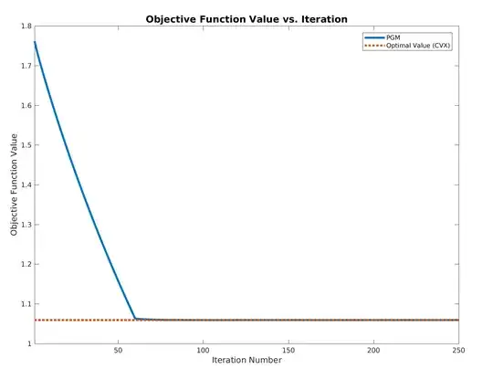

In order to be practical I will solve the following:
$$ \arg \min_{x} \frac{1}{2} \left\| A x - b \right\|_{2}^{2} + \lambda \left\| x \right\|_{\infty} $$
The approach I will take is by using the Proximal Gradient Method (PGM).
There is an accelerated version of the PGM (See FISTA on Wikipedia's reference) but we'll leave it out currently.
Defining $ f \left( x \right) = \frac{1}{2} \left\| A x - b \right\|_{2}^{2} $ and $ g \left( x \right) = \left\| x \right\|_{\infty} $. This fits the Composite Model of PGM.
The iteration is given by:
$$ {x}^{k + 1} = \operatorname{Prox}_{{t}_{k} \lambda g \left( \cdot \right)} \left( {x}^{k} - {t}_{k} \nabla f \left( {x}^{k} \right) \right) $$
As written in Proximal Operator of Infinity Norm:
$$ \operatorname{Prox}_{{t}_{k} \lambda g \left( \cdot \right)} \left( v \right) = \operatorname{Prox}_{ \lambda {\left\| \cdot \right\|}_{\infty}} \left( v \right) = v - \lambda \operatorname{Proj}_{ \left\{ \left\| \cdot \right\|_1 \leq 1 \right\} }( \frac{v}{\lambda} ) $$
So it yields:
$$ {x}^{k + 1} = {w}^{k} - {t}_{k} \lambda \operatorname{Proj}_{ \left\{ \left\| \cdot \right\|_1 \leq 1 \right\} }( \frac{ {w}^{k} }{{t}_{k} \lambda} ) $$
Where $ {w}^{k} = {x}_{k} - {t}_{k} \nabla f \left( {x}^{k} \right) $, $ {y}_{k} $ is the step size and $ \operatorname{Proj}_{\mathcal{C}} \left( x \right) $ is the projection operator on $ \mathcal{C} $.
The projection onto the $ {L}_{1} $ ball is given in Orthogonal Projection onto the $ {L}_{1} $ Unit Ball.
This is the MATLAB Function:
function [ vX, mX ] = SolveLsLInfProx( mA, vB, paramLambda, numIterations )
mAA = mA.' * mA;
vAb = mA.' * vB;
vX  = pinv(mA) * vB; %<! Dealing with "Fat Matrix"
stopThr = 1e-6;
stepSize = 1 / (2 * (norm(mA, 2) ^ 2));
% stepSize = 1 / sum(mA(:) .^ 2); %<! Faster to calculate, conservative (Hence slower)
mX = zeros([size(vX, 1), numIterations]);
mX(:, 1) = vX;
for ii = 2:numIterations
    vG = (mAA * vX) - vAb;
    vV = vX - (stepSize * vG);
    vX = vV - (stepSize * paramLambda * ProjectL1Ball(vV / (paramLambda * stepSize), 1, stopThr));
    mX(:, ii) = vX;
end
end
The full code (Including validation against CVX) is in my StackExchange Mathematics Q1857714 GitHub Repository (Including the code for $ {L}_{1} $ Ball projection).
The nice thing about this method is how nice it generalizes.
Namely take the code and just replace $ \nabla f \left( x \right) $ with your own function gradient and it will work.
