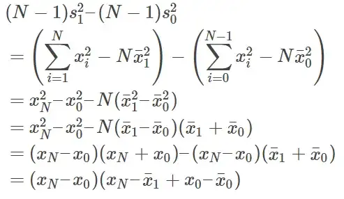

If we kept track of $m_k$, $v_k$, and $\sigma^2$ for each sample, then could we easily compute the variance for a given window of samples between $i$ and $i+j$ with a simple manipulation of those saved values?

Looks like an answer can be found here: http://jonisalonen.com/2014/efficient-and-accurate-rolling-standard-deviation/
If the window is moving from $$(x_0,...,x_N-_1)$$ to $$(x_1,...,x_N)$$ then:
ChaimKut
