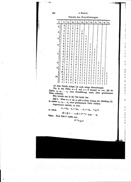

  • Andre, in case of interest, A. Hurwitz considered exactly this in 1907, that is $$ x_1^1 + x_2^2 + \cdots x_n^2 = a x_1 x_2 \cdots x_n, $$ mostly for $n \geq 3.$ Maybe I should post his table for $n \leq 10.$ For a fixed $n,a$ all solutions make up a forest, movement between solutions in a tree is by "Vieta Jumping." – Will Jagy Jul 07 '16 at 18:18
  • @WillJagy: Thank you, I knew there was a literature. But though I can kind of remember what I have seen, where I have seen it has never been easy, and is not getting easier. Of course the particular case of this problem is not an issue, we have all assigned variants of it in elementary number theory courses. – André Nicolas Jul 07 '16 at 18:38
  • Andre, my websites have been revived, in shortened forms. Here is the Hurwitz article http://zakuski.utsa.edu/~jagy/Hurwitz_A_1907.pdf It really is worthwhile, the assistance for most contest type problems is to say "Vieta Jumping as contest people call it, is just the first step, after which we have a set of inequalities defining a region to search for integer solutions..." This has been very helpful to me. – Will Jagy Jul 07 '16 at 18:45
  • Using the Hurwitz viewpoint, very proud of this one, http://math.stackexchange.com/questions/829228/is-it-true-that-fx-y-dfracx2y2xy-t-has-only-finitely-many-distinct-i although it took a few tries and I still needed some help – Will Jagy Jul 07 '16 at 18:47
    @WillJagy: Thank you, bookmarked. – André Nicolas Jul 07 '16 at 18:52
In 1907, A. Hurwitz considered $$ x_1^2 + x_2^2 + \cdots + x_n^2 = x \, x_1 x_2 \cdots x_n $$ The conclusions, with all the $x_i \geq 0$ integers and $x$ an integer, included $x \leq n.$ The main thing, though is that, for a fixed pair $n,x,$ all solutions collected into a finite set of rooted trees. Travel within a tree is by "Vieta Jumping." He called a tree root a Grundlösung, I usually say fundamental solution. He gave enough inequalities to find all fundamental solutions for any given pair $n,x,$ including showing when there were no actual solutions using that pair.
making jpeg, just a minute
