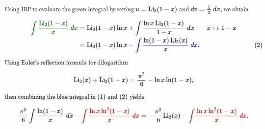

In this accepted answer, @Tunk Fey proved the above. (See $(4)$). However, I have the following $3$ queries :
  • Why can we add the integrals after the substitution $x \mapsto 1-x$ in the following step? I doubt it since $\int f(x) \ \mathrm{d}x \neq \int f(1-x) \ \mathrm{d}x$ in general.
  • Why do we omit the constant of integration in the following step? We should add the constant since it will affect the summation.

Note: OPs doubts seem reasonable to me, since the identity stated in OPs question is not correct. In the following we are going through @TunkFey's answer and try to put the focus to weak points in his argumentation. But, nevertheless I'd like to emphasize that it was a pleasure to go through his answer which was also instructive and inspiring to me.

He continues with (question marks emphasis mine)
(Tunk Fey:) Using IBP to evaluate the green integral by setting $u=\operatorname{Li}_3(1-x)$ and $dv=\frac1x\ dx$, we obtain
\begin{align*} \color{green}{\int\frac{\operatorname{Li}_3(1-x)}x\ dx}&=\operatorname{Li}_3(1-x)\ln x+\int\frac{\ln x\operatorname{Li}_2(1-x)}{1-x}\ dx\qquad x\mapsto1-x\\ &\stackrel{???}{=}\operatorname{Li}_3(1-x)\ln x-\color{blue}{\int\frac{\ln (1-x)\operatorname{Li}_2(x)}{x}\ dx}.\tag{3} \end{align*}
OP: Why can we add the integrals after the substitution $x \mapsto 1-x$ in the following step? I doubt it since $\int f(x) \ \mathrm{d}x \neq \int f(1-x) \ \mathrm{d}x$ in general.
The substitution $x\mapsto 1-x$ is not valid in Tunk Fey's answer. We can use it e.g. in case of definite integrals by also respecting the limits of the integral. But as OP claimed in general is the substitution not admissible.

The next step is to combine $\int\frac{\ln(1-x)\operatorname{Li}_2(1-x)}{x}\ dx$ and $\int\frac{\ln(1-x)\operatorname{Li}_2(x)}{x}\ dx$ with the help of the Euler's reflection formula \begin{align*} \operatorname{Li}_2(x)+\operatorname{Li}_2(1-x)=\frac{\pi^2}{6}-\ln x\ln(1-x) \end{align*}
He obtains \begin{align*} \sum_{n=1}^{\infty}\frac{H_nx^n}{n^3}&=\zeta(3)\ln(x)+\frac{1}{2}\int\frac{\ln x\ln^2(1-x)}{x}\ dx +\operatorname{Li}_4(x)-\operatorname{Li}_3(1-x)\ln x\\ &\qquad+\int\frac{\ln(1-x)\left(\frac{\pi^2}{6}-\ln x\ln(1-x)\right)}{x}\ dx\\ &=\zeta(3)\ln(x)-\frac{1}{2}\int\frac{\ln x\ln^2(1-x)}{x}\ dx+\operatorname{Li}_4(x)-\operatorname{Li}_3(1-x)\ln x\\ &\qquad-\frac{\pi^2}{6}\int\frac{\ln(1-x)}{x}\ dx\\ &=\zeta(3)\ln(x)-\frac{1}{2}\int\frac{\ln x\ln^2(1-x)}{x}\ dx+\operatorname{Li}_4(x)-\operatorname{Li}_3(1-x)\ln x\\ &\qquad-\frac{\pi^2}{6}\operatorname{Li}_2(x)\tag{5} \end{align*}
The next step is to simplify $\color{red}{\int\frac{\ln x\ln^2(1-x)}{x}\ dx}$. He continues with (question marks emphasis mine)
(Tunk Fey:) Setting $x\mapsto1-x$ and using the identity $H_{n+1}-H_n=\frac1{n+1}$, the red integral becomes \begin{align*} \color{red}{\int\frac{\ln x\ln^2(1-x)}{x}\ dx}&\stackrel{???}{=}-\int\frac{\ln (1-x)\ln^2 x}{1-x}\ dx\\ &=\ldots\\ &=\frac12\ln^2x\ln^2(1-x)-2\ln x\left[\sum_{n=1}^\infty\frac{H_{n} x^{n}}{n^2}-\operatorname{Li}_3(x)\right]\\ &\qquad+2\left[\sum_{n=1}^\infty\frac{H_{n} x^{n}}{n^3}-\operatorname{Li}_4(x)\right]\tag{6} \end{align*}
The substitution (???) right at the beginning is not justified and not admissible. It will also have some influence when calculating the integration constant at the end.
