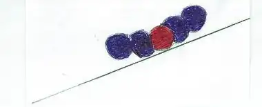

But you have to consider the tangent of a singular point. The tangent only touches a specific singular point and does not touch the neighbour points. There is only a unique tangent which meets this condition. The picture below shows that only one straight line can touch the red point without touching one of the blue points. Any other straight line would touch or intersect one of the neighbour points. With some effort one can imagine this situation for infinitesimally small points.
callculus42
  • 30,550
    What do you mean ? Please be more specific. – callculus42 Jul 01 '16 at 16:51
  • Read my question.. – anonymous Jul 01 '16 at 16:52
  • Read my answer. You have to consider one single point. Any other case doesn´t make sense. And don´t be so rude. – callculus42 Jul 01 '16 at 16:56
  • @callculus What about a line perpendicular to your given one? It wouldn't touch any point on the curve (in this region) except the red one. Really OP's (and your) idea of the tangent line as the unique line which only touches the curve once is full of problems. See lulu's comment on the question. –  Jul 01 '16 at 16:56
  • @Bye_World It will intersect one of the points. – callculus42 Jul 01 '16 at 16:58
  • How? Does the curve contain a cusp at that point? –  Jul 01 '16 at 17:00
  • @Bye_World It has one single point where the tangent touches one single point. That is what we do if $\Delta x \to 0$ – callculus42 Jul 01 '16 at 17:05
  • Taking lulu's example, consider the curve given by $f(x)=x$. Is there any way to restrict the interval around say the point $(1,1)$ such that the tangent line only passes through that point on the curve? Now consider any other line through that point. Will it pass through any other point on the curve $f(x)$? –  Jul 01 '16 at 17:06
  • Sorry, but you're just wrong. This is not how we define the tangent line to a curve and your definition isn't even well-defined. –  Jul 01 '16 at 17:06
  • @Bye_World Sorry I do not consider tangents for straight lines. This doesn´t make sense. – callculus42 Jul 01 '16 at 17:08
  • OK. Fine. That's crazy... but fine. Consider the curve $f(x)=e^x$ at the point $(0,1)$. The tangent line at that point is $g(x) = x+1$, do you agree? Now consider the line $h(x) = -x+1$ (or even $h_1(x) = 1$). This line only intersects the graph of $f(x)$ at the point $(0,1)$ but it is clearly not the tangent line to the graph. –  Jul 01 '16 at 17:14
  • @Bye_World In my answer I´m talking about touching, not intersecting. The purpose of the picture is to give a imagination of a tangent of a function. – callculus42 Jul 01 '16 at 17:24
  • "Touch" has no rigorous meaning in mathematics. You're free to come up with your own definition of it if you like, but if you don't clearly define it, people will assume you mean "intersect" -- which does have a clear mathematical definition. (Especially when your own answer states that "any other line would touch or intersect one of the neighbour points." Which I've already demonstrated is false.) –  Jul 01 '16 at 17:27
  • @Bye_World I don´t know if it is really true that touching has no rigorous meaning in mathematic, but it is often used in school and university. – callculus42 Jul 01 '16 at 17:31
  • Teachers and professors use a lot of informal language to try to get students to understand the concepts. You'll find that they do it less as you progress through your mathematical education, though. Even taking the word "touch" informally in your answer, I still don't see any way in which this correctly explains why there is only one tangent line to any point on a differentiable curve. –  Jul 01 '16 at 17:33
  • @sani Oh, you are a child. In this case I have to forgive your rudeness for this time. – callculus42 Jul 01 '16 at 17:36
