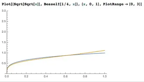

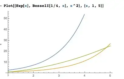

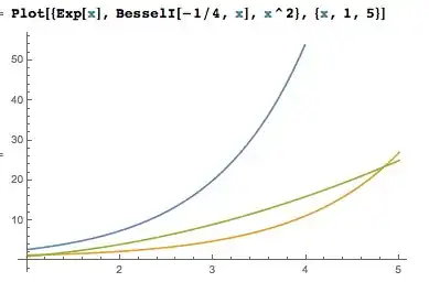

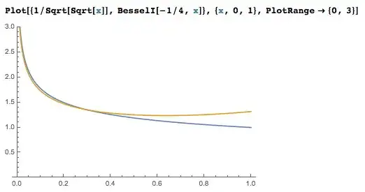

It is worth graphing these functions (and playing with the parameters). For $x>1$ they are both monotone a similar rate of growth to an exponential. The difference is over the range $[0,1]$, where $I_{\frac{1}{4}}$ is more like $x^{\frac{1}{4}}$ and $I_{\frac{-1}{4}}$ is more like $\frac{1}{x^{\frac{1}{4}}}$.
But the main point I want to make is that our classification of some functions as elementary is somewhat arbitrary and mainly historical accident. If it was done from scratch on a more rational basis, many other functions, including these two, would be classified as elementary. They have power series, interesting relations, smooth curves etc. Plus of course it is just as easy to get their values, plot them, manipulate them etc with the proper software, as it is with cosine or log.
The first two graphs show the two Bessel functions against the corresponding powers of $x$ in the range $[0,1]$. In each case the brown curve is the Bessel function.
In the next two you see the range $x>1$: the blue curve is the exponential, the green curve is a polynomial, and the brown curve is the Bessel function.
