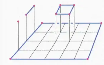

I feel this "perturbation (or deformation) trick" is of quite a fundamental nature. Above is a picture of part of a deformation involved in the proof of the 2-dimensional Seifert-van Kampen type theorem, for the crossed module involving a triple $(X,A,C)$ of spaces where $C$ is a set of base points, and $C \subseteq A \subseteq X$.
The red dots denote points of $C$. The blue lines denote paths lying in $A$. The small squares in the bottom are supposed to denote squares lying in a set $U$ of an open cover. By making connectivity assumptions you can deform a small bottom square into the top one of the right kind, and still lying in the same open set. So, by working with a double groupoid construction $\rho_2(X,A,C)$ whose compositions are more 2-directional than the usual relative homotopy groups, you can get going with the proof of a universal property involving double groupoids, and hence for crossed modules.
