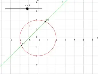

For intersection points both equations $$ y = x + d \\ x^2 + y^2 = 2^2 $$ must hold. Inserting the first into the second we get $$ y = x + d $$ and $$ 2^2 = x^2 + (x+ d)^2 = 2 x^2 + 2xd + d^2 \iff \\ 2 = x^2 + x d + d^2/2 = (x + d/2)^2 - d^2/4 + d^2/2 \iff \\ 2 - d^2/4 = (x + d/2)^2 \iff \\ x = \frac{-d \pm \sqrt{8 - d^2}}{2} $$ Which gives the solutions $$ P = \left( \frac{-d \pm \sqrt{8 - d^2}}{2}, \frac{-d \pm \sqrt{8 - d^2}}{2} + d \right) $$ The number of real solutions is determined by the argument of the square root $$ \Delta(d) = 8 - d^2 $$ If $\Delta(d) = 0$ or $d = \pm\sqrt{8} = \pm 2\sqrt{2}$ there is one solution.
If $\Delta(d) > 0$ or $\lvert d \rvert < 2\sqrt{2}$ there are two solutions.
If $\Delta(d) < 0$ or $\lvert d \rvert > 2\sqrt{2}$ there is no (real) solution.
You can fiddle with it here.
mvw
  • 34,562
  • Thank you, mvw, I appreciate the explanation...especially the interactive graph you linked to! :) – jbrow35 Jun 24 '16 at 22:11
