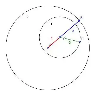

PROOF Let $B=B(x;\epsilon)$ be an open ball around $x\in X$ with radius $\epsilon$. Let $y\in B$. We want to prove there is an open ball around $y$ contained in $B$. Let $\delta=\epsilon -d(x,y)$. We claim if we let $r<\delta$ then $B'=B'(y,r)\subset B(x,\epsilon)$. Indeed, let $x'\in B'$. Then $$\begin{align} d(x',x)&\leq d(x',y)+d(y,x) \\ &<\epsilon -d(x,y)+d(x,y)\\&=\epsilon. \end{align}$$
Maybe an image would have been nicer:
$\hspace{4.5 cm}$enter image description here
